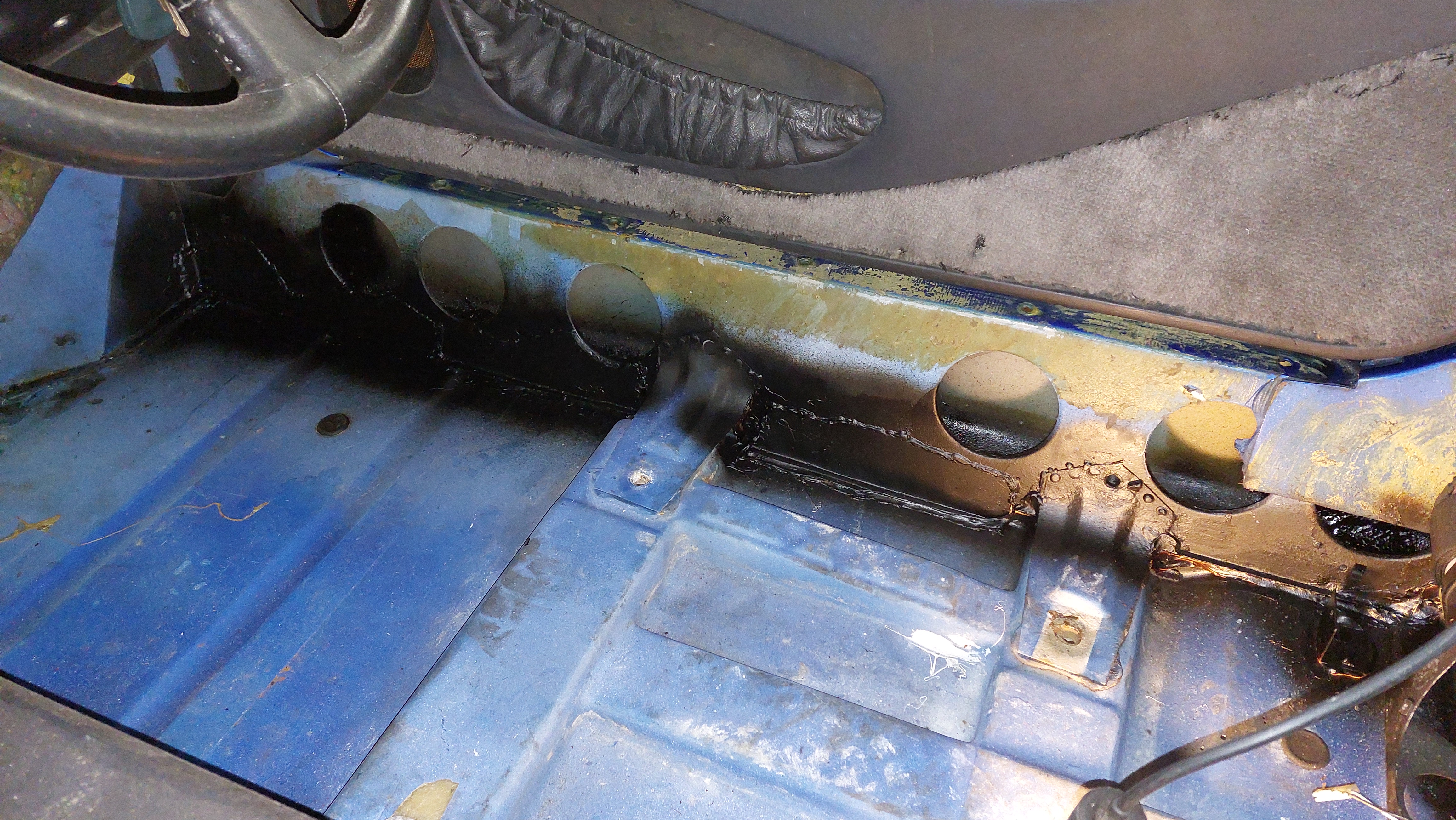

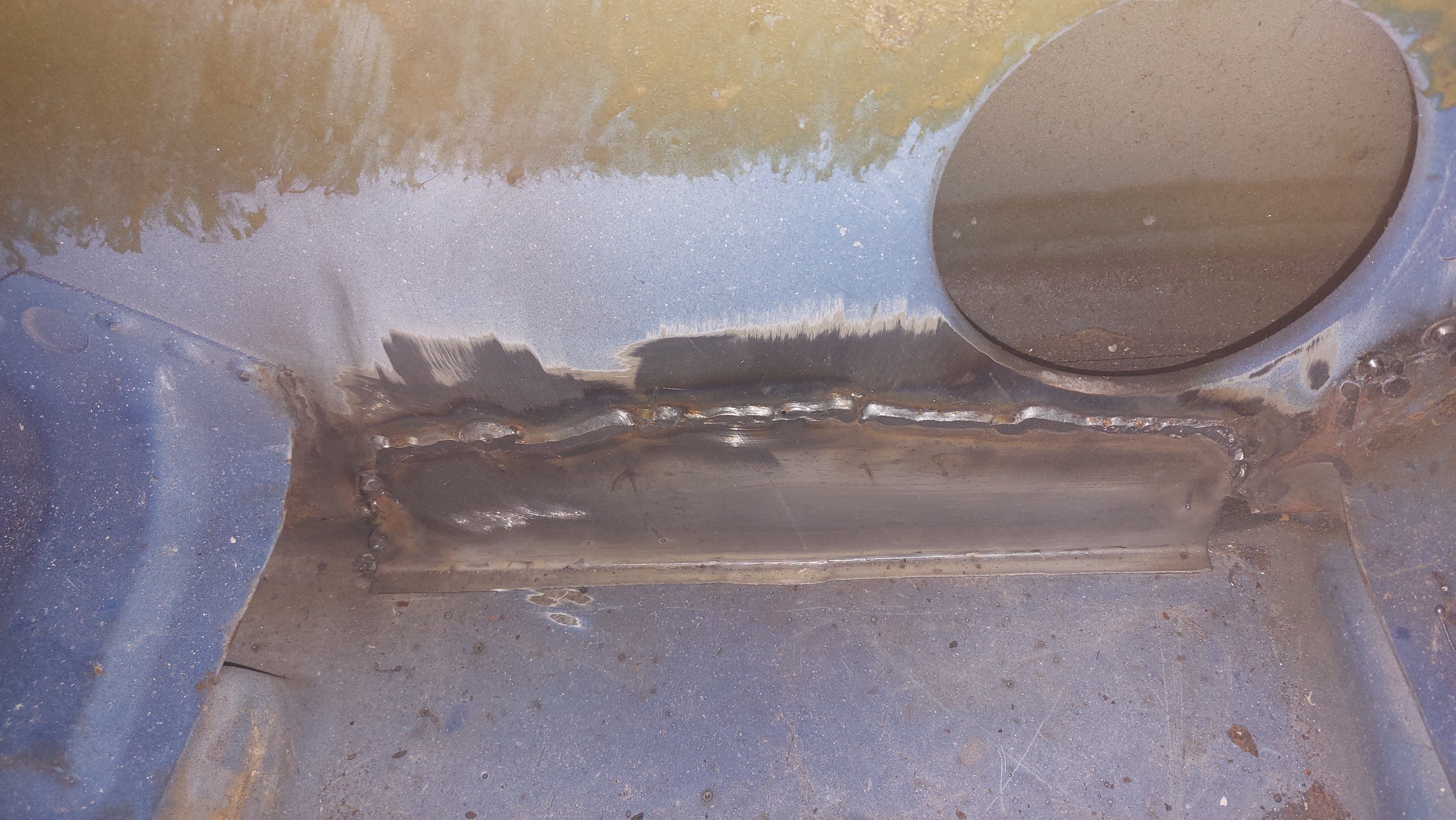

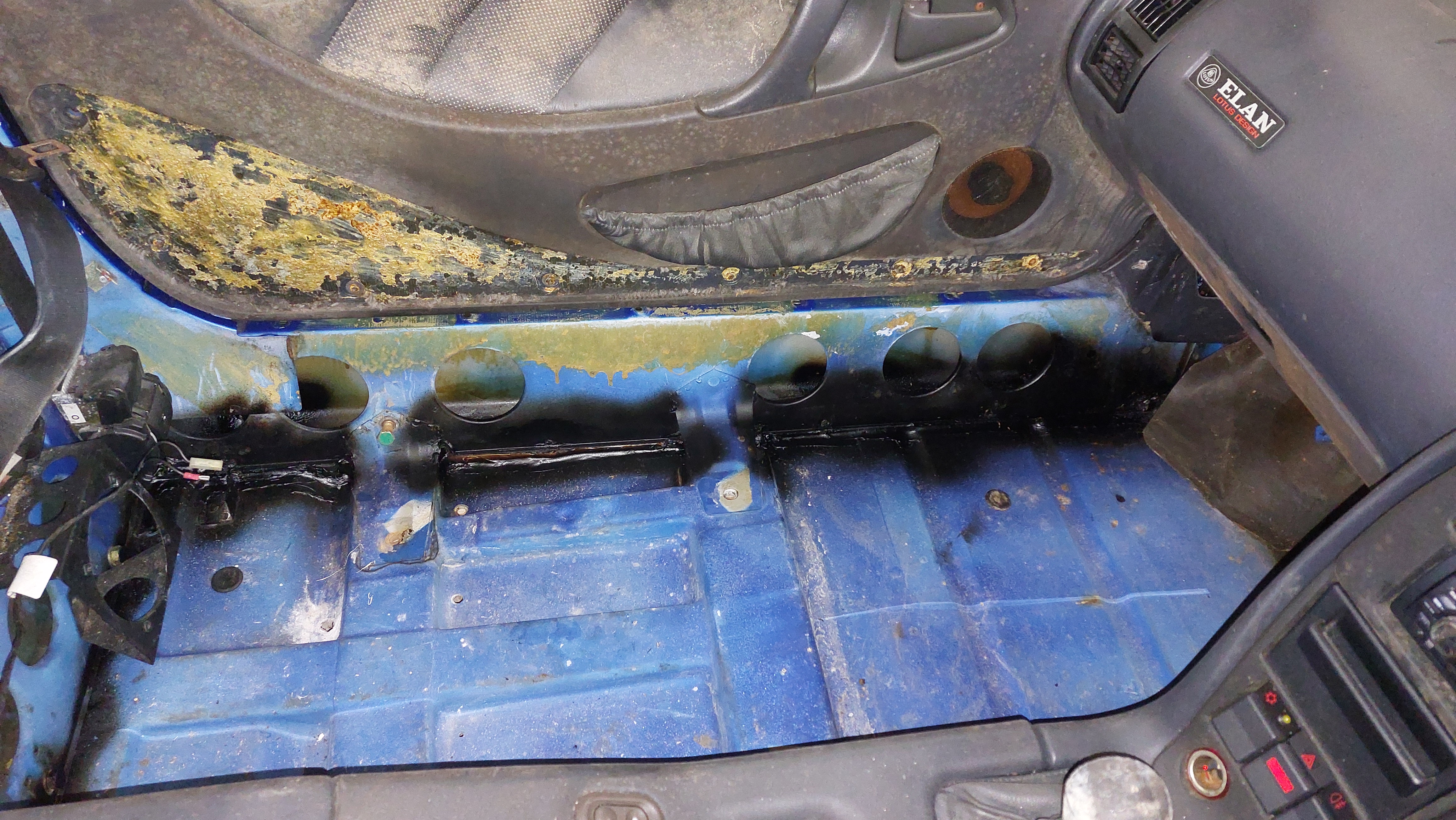

Anyway, lest show some actual progress - I have now finished the inner sills/jacking point work - and drilled some holes in the floor to allow any future water to escape easily.
I have never claimed to be any sort of welder, and usually add far too much 'filler' as I go - it may not look as good as a pro will do, but it certainly isn't going to fall apart!
All treated and ready for the next 30+ years

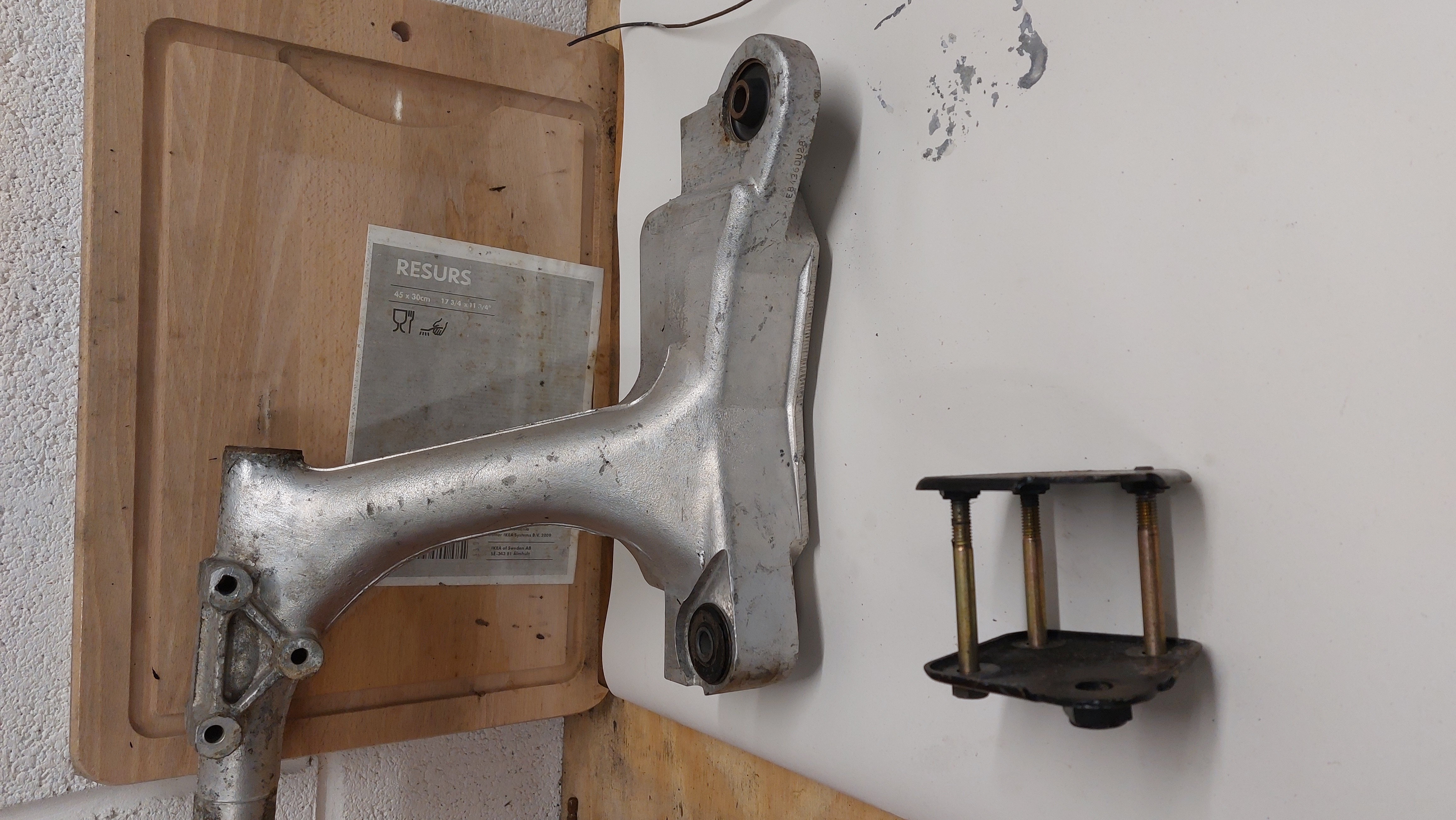

All new bushes are now pressed into the rafts, so they're ready to go in.

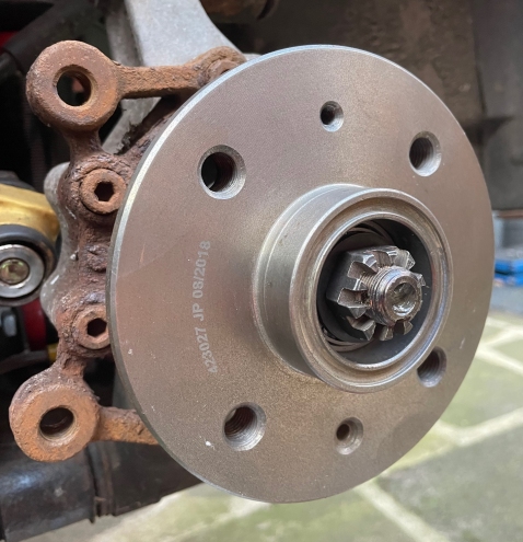

A quick Hub experiment update, awaiting the splitting of the thread....
Before you read on, a warning....
All modifications to braking systems are carried out at your own risk - If in doubt get a qualified engineer to help or do this for you.
I only have OEM and Civic Type R rear calipers to play with, so can't vouch for PNM, Hi-Spec or any other caliper you may have fitted.
I fitted the Daewoo-type hub onto my car yesterday.
There's one large and two small differences to BB's hubs:
a. The overall diameter is 136mm vs BB's 122mm - but there seems to be enough "Meat" on the hub to have it turned down.
b. The hub centring spigot is 57mm vs BB's 60mm - an alloy spigot ring could make up the difference.
c. The hub locating screw hole may need to be re-drilled and tapped to suit the disk used.
To use this hub with the APEC DSK117 disk which is usually fitted with OEM calipers you'd need to get the hub turned down to 122mm/120mm as per the hub drawing further up the thread, then use a 57.1 to 60.1 spigot ring between disk and hub which will get you very close to OEM specs.
However, the disk I used for this test was an APEC DSK297, it's a 240mm disk, 42mm high, 10mm thick. It has a 57mm centring spigot hole so there was no need for a spigot ring, and the hub fits nicely inside the disk bell.

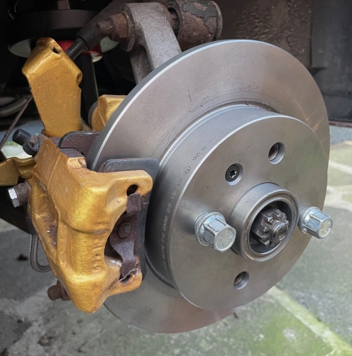

It fits into the caliper with room to spare, and there's a 2mm area on the outer edge of the disk which is unswept by the pads.
The disk inner face sits around 1mm closer to the caliper carrier than the OE hub/disk combo which results in the sliding pin bolts just scraping the disk, so I needed to either shorten the sliding pin bolts by 1mm or insert a washer between the slider pins and caliper carrier.
I haven't tested the handbrake as yet, and I need to find out if the OEM calipers are OK to use with a 10mm thick disk before carrying on down this route, but it looks promising so far.

dapinky wrote:Anyway, lest show some actual progress - I have now finished the inner sills/jacking point work - and drilled some holes in the floor to allow any future water to escape easily.
Are the rafts the ones from my car?

The rafts were from yours, yes. I had to drill out one of the bolts at the top plate which had seized into the aluminium, but that was just time-consuming and boring - then clean them up, remove the knackered bushes and press in the new ones.... now ready to go!

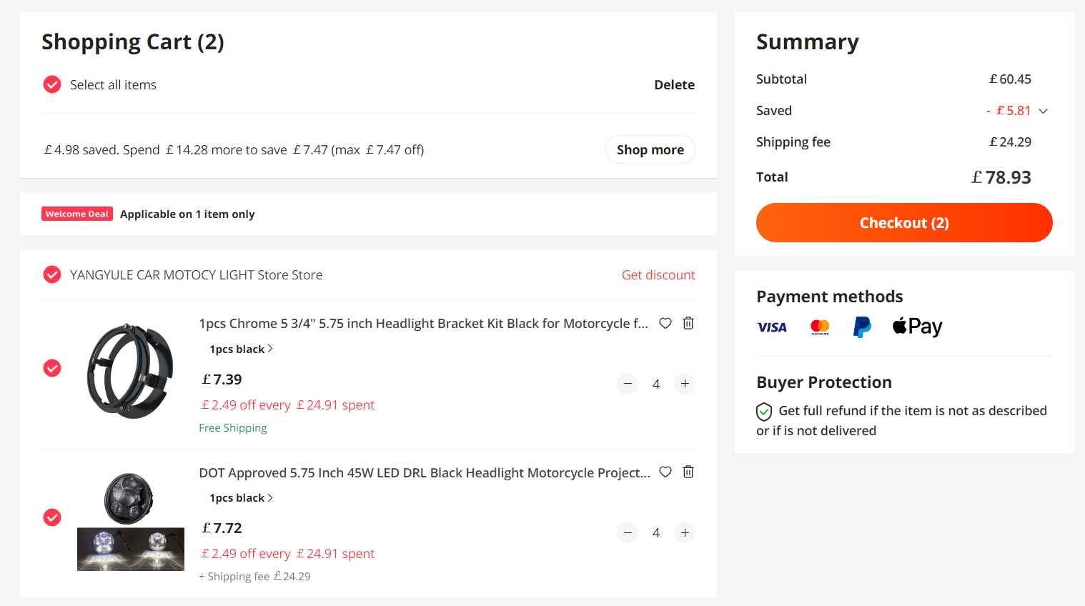

I haven't actually ordered the headlamps - I don't know how good (or not) the current ones are, but the list shows them as a 'possible'. That said, I won't be getting them from PNM as I have found a seller (in China!) who can supply 4 LED units to UK spec and 4 mounting rings (with the adjuster screws) for a lot less cash.
£80 seems like a reasonable gamble to see if they arrive and can be made to fit & work!
If the current mounting rings are rust-free (or easily repairable) then I may just try the lamp units, but if they are beyond (easy) use I may try the mounting rings and find a way to fit them to the pods.

dapinky wrote:£80 seems like a reasonable gamble to see if they arrive and can be made to fit & work!
if that works, its probably better than getting the neolite replacements i have found last year. i recall my rebuilding costs were 50 for the light units. plus 40 for the chrome surrounds while i reused the metal backing plates and original plastic rims
and i have low expectations of the neolite units given the amount of wear i witnessed on the ones fitted back in 2014-15

My concern is that the mounting rings will sit too far forward, so may need to be adapted somehow...... when I did my car, I made the metal mounting plates from aluminium (can't remember what thickness, probably 3mm, but I can easily measure it), re-used the plastic, and had some chrome rings in the spares pile for the Triumph.
It may be that I can cut some aluminium plate again to mount to the Elan pods, and find a work-around. All that is well in the future though, and is just musings at the moment.
