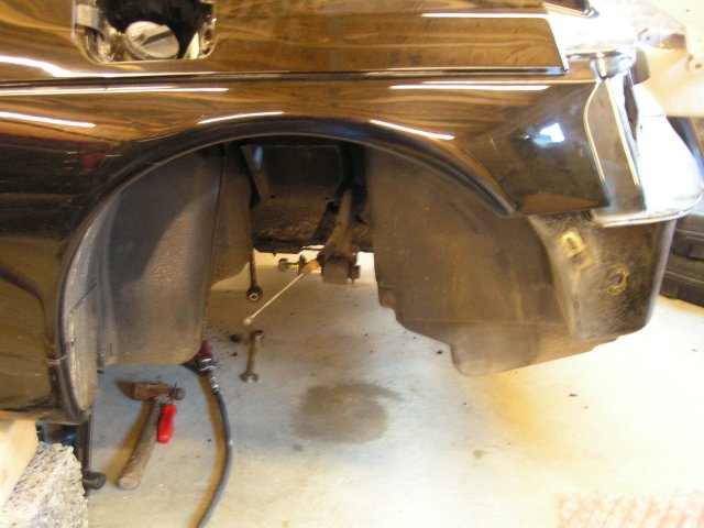

Feels like thats all Im doing, nothing constructive. I keep thinking, at what point am I going to get lost. There has to be a point when things start going back together, sadly that seems to be nowhere in sight.
The plan is to get the chassis rolling and fit new brake pipes, the ones that run along the chassis. But first I have to remove all the suspension off the old car and recondition / replace it as I go. Im trying to get together all the parts that will be galvanised so I can have them done at the same time.
Removing the back suspension was fun, the cam-bolts were seized. I managed to salvage one but if I cant get one for the other side looks like I'll be making the other!
Rear suspension off

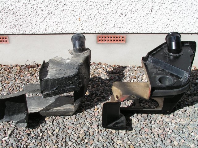

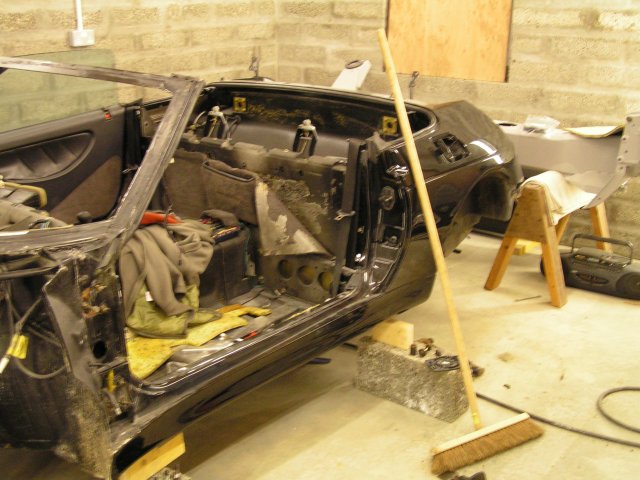

Bulkhead carpet didn't lend itself to coming off - ruined + N.L.A.
You won't see me resting brush on new shell!
Looking for a little T.L.C.

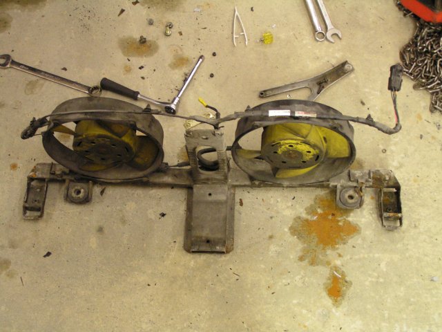

X member and radiator and fans removed
Spot the difference - no it wasn't me

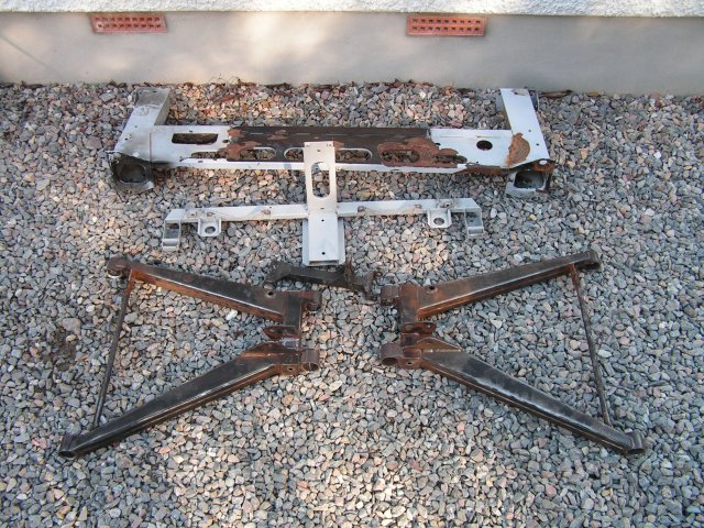

Bits off to get blasted and galvanized today should get them back 7-10 days time, just typical Im on night shift and its a 70 mile drive to the galvainzers. :|
Just in case anyones interested, rear wishbone bushes had to burnt out and metal parts had to be cut in order to remove remainder. :smt013
Prices of all 12 bushes (inner bushes come in halves) aint cheap, but certainly better than forking out funny money for 2 genuine wishbones. :shock:
Front frame / x-member has some surface rust but a good blast will get rid of that, I hope when it gets dipped in the galv bath the heat doesn't distort it too much, had to remove the small M5 studs that hold on the fans and just bored a hole to accept a M6 bolt (stainless), the M5 studs wouldn't have stood up to running a die down them to remove excess galv coating. As it is I've a few M6 and M8 threads that I will have to re cut - fingers crossed!
Once the wishbones are galvanized they should be good for a few years, just glad I cought them in time! :smt117

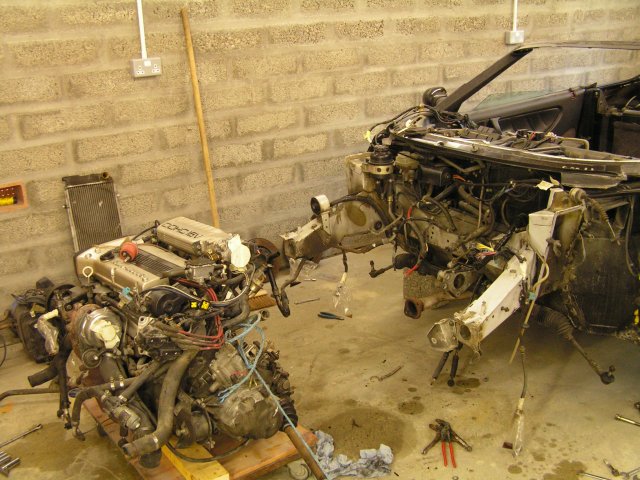

Front suspension and engine out this weekend, beautiful weather outside and Im stuck in the garage. :(

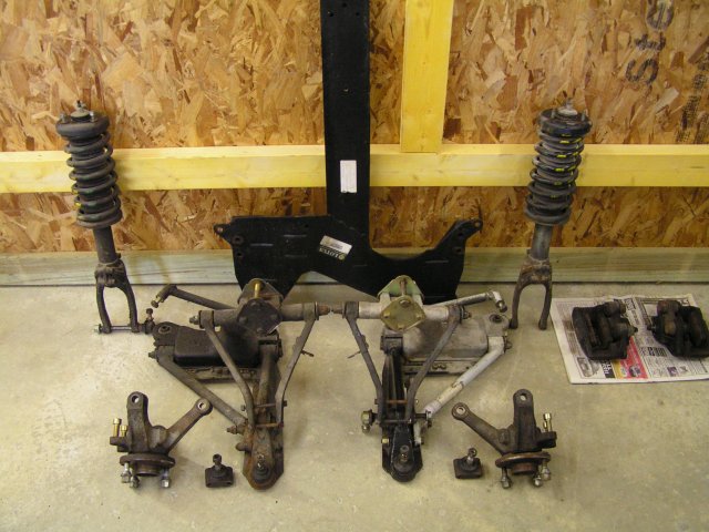

N/S/F/ suspension no bother to come off as some of it was replaced last year, prongeron still got lotus stickers on it but that will have to go grey - another visit to the spray booth. O/S suspension a bit crusty but salvagable.
Ive got new front struts to replace existing ones, just as well because the N/S one is bent!

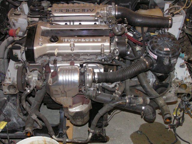

Engine out a fun job not much room behind engine to swing a cat never mind a ratchet. I'll take my hat off to the guys who have done this with the front end built up, its bad enough with everything stripped off. Time I invested in a two post lift!
Strut on right is bent where yokes bolt on
Is this the point where Im supposed to say F**k this and call it a day?
