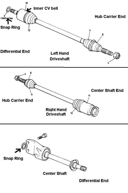

You need to disconnect the driveshaft from the gearbox/differential and to do that, you need to remove the hub carrier from either the upper or lower ball joint as well as disconnect the hub carrier from the steering rack. That is why you need a ball joint tool. Once the hub carrier is free, it will rotate on the remaining ball joint allowing you to disconnect the driveshaft from the gearbox/differential.
For the near side, you use a "sharp" blow/hit with a decent hammer to the inner CV bell or use a CV joint fork (like an oversize ball joint fork) to pop it out of the differential gear. There is a snap ring on the gearbox end of the driveshaft that keeps it in the gear until it is forced out.
For the off side, you need to disconnect the driveshaft from the Center Shaft which is what Lotus used to make the driveshafts the same length and reduce the torque steer that is a problem in FWD cars.
You might have to remove the driveshaft and Center Shaft together by removing the 2 bolts holding the Center Shaft to the engine and take it to a local shop for them to separate them for you.
Once the driveshaft is out of the differential / Center Shaft, use the puller to push the driveshaft out of the bearing in the hub carrier.
Pictures of the different shafts:

This is all a mystery to me - I've never had to remove the whole shaft (or split it) to get the hub off the shaft to get to the CV boots - but often choose to.....
.... but there is another 'option' (as mentioned by John) to avoid taking the whole shaft out of the gearbox and loosing the gear oil.
If the hub is now loose from the rest of the car, but still attached to the drive shaft, the inner CV joint can be seperated (it is only a sliding fit anyway - nothing to really undo, except the rubber boot).
By undoing the big metal band on the inner boot, it is possible to then seperate the CV joint by sliding the outer end of the drive shaft towards you) still with the hub attached to it....
The centre shaft stays in the car - basically, seperating items 11 from 12 in the above pictures.
Once you have the driveshaft (with the hub still attached) on the workbench you have a choice:-
1) Seperate the shaft from the hub
2) leave it alone!
I'd go for 1) if you can do it yourself, or 2) if you'd have to take it somewhere - it doesn't need to come off, but just makes it easier to work with and replace the shaft in the car afterwards.
Once you seperate 11 from 12 you will see that 12 is just - basically - a tube with 3 grooves cut into it. Under the boot (11) is a 3-legged 'spider' which fit into the grooves.
You will be wondering how you are going to get the boots on/off without damage, but it is actually really easy (and this is why I usually split the shaft to do it anyway to avoid stretching the boots over anything!)....
...Clean the grease off the 3-legged spider and you will find that the end of the shaft is splined, with the spider pushed onto it. It is held in place by a standard circlip.
If you undo the circlip, the spider will pull off the end of the shaft.
Now it is really easy to change the boots as they will simply slide off and on again.
Once the boots are replaced, simply replace the spider and the circlip and refit the shaft into the tube in the centre shaft, do up the inner boot (item 11) and re-attach everything!

if i understand this currectly, the shafts on both sides are different? this seems really weird. i would expect them to be identical,
the side im working on is the passenger side for UK spec, (if your sitting inside it it will be on your left hand side ,near the fusebox? )
My understanding at the moment is that i cannot escape the fact that the axle will have to come out from the inner CV joint side. correct ?
if the shaft needs to be disconnected from there, i can just slide the boot from that side without needing to take the hub out.
on the pictures you put up. i recognise the left hand driveshaft, but the picture there has the hub already taken out.

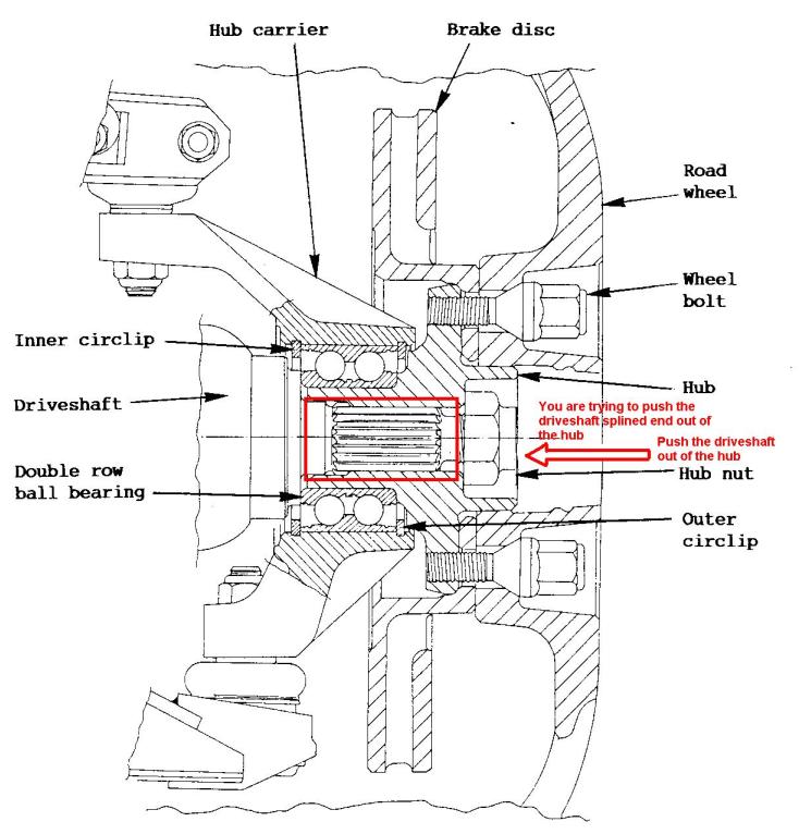

You can't push the driveshaft out without giving it room to move. The hub STAYS connected to the hub carrier. The hub carrier should be disconnected from the lower ball joint and the track rod end so the assembly can rotate outward on the upper ball joint creating enough room to push the driveshaft out of the hub.
You need to be able to rotate the hub carrier away from the center of the car to push the shaft out. Dave P. is correct that you don't really have to remove the driveshaft from the differential, but it gets tight under the car working on the inner CV boot if you don't.
Click on picture to see full size

Brit-Car-Nut wrote:You can't push the driveshaft out without giving it room to move. The hub STAYS connected to the hub carrier. The hub carrier should be disconnected from the lower ball joint and the track rod end so the assembly can rotate outward on the upper ball joint creating enough room to push the driveshaft out of the hub.

I think i get it now. gonna have to give it another go tomorow, i think the issue is that i left the hub rest on the lower ball join while trying to pull the shaft out of the hub (video i saw on youtube was a bit missleading), im afraid that didnt do any good to the ball joint either, Tomorow after a second attempt (and a new puller) ill drop an update.
