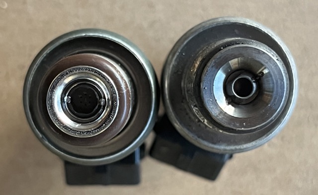

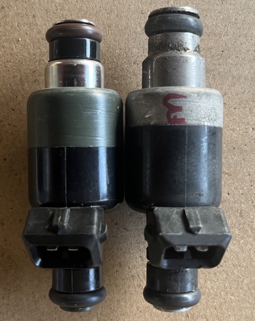

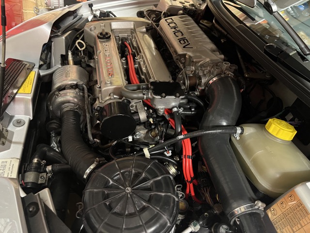

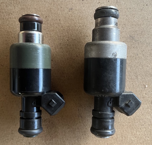

A little work on the Elan this Christmas - I've done an oil change to the 10W50 which has brought the oil pressure down as expected. The oil filter is in a terrible spot - each time I do it I manage to fumble and drop it (open side down) on the exhaust. Bloody stupid place to put an oil filter.

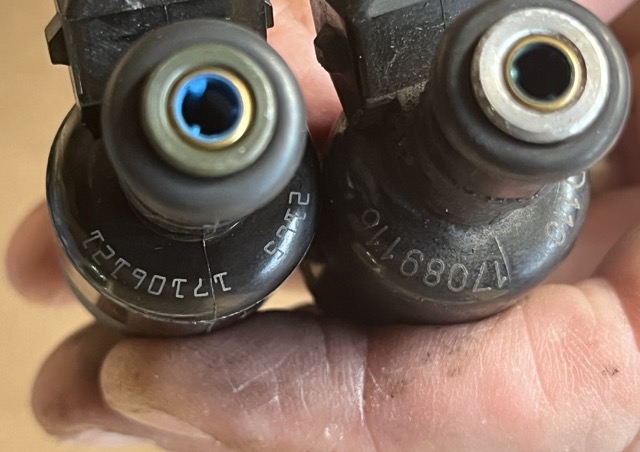

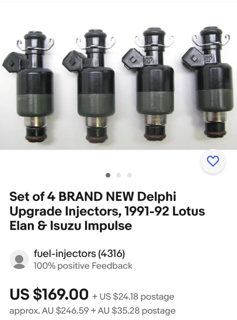

I have also replaced my injectors, and I am very pleased with the improvement. With thanks to Matt for the recommendation, I picked up a set of well priced replacements from the US.
https://www.ebay.com.au/itm/191637275013
For the installation I followed the WikiLEC instructions which were excellent, thank you for those; it was fiddly but not hard. I put the front up on ramps to make it a bit easier to reach everything. The fuel rail bolts would not budge with a ratchet but the impact driver whipped them out in a moment. I really only had three problems:
1. The electrical connectors were very brittle. I managed to break off the little locking tab on each and one connector was already chipped quite badly. I've ordered a new set of connectors and will replace them all.
2. I could not get the new injectors in to the top rail first per the instructions. I found it much easier to put them in to the head, and then push the fuel rail down on to it. I put the bolts back in the rail, and then levered them up to the correct height which I found quite easy to do.
3. On first start it sounded awful, I am fairly sure it was not firing on more than 2 or 3 cylinders - bad enough that my wife came out to let me know I shouldn't have messed with it! I gave each connector a spray with WD40 and jiggled them in to position which cured it (new connectors will solve that).
Just a quick test drive tonight with a fire extinguisher on the passenger seat and a beautiful full moon above (roof down to make rapid escape from a burning Elan easier!). Subject to a proper test tomorrow, I think that it was noticeably more powerful and was boosting to 0.6bar in all gears.

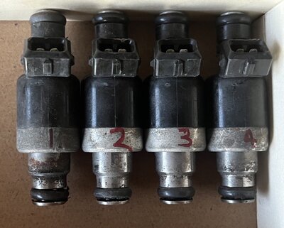

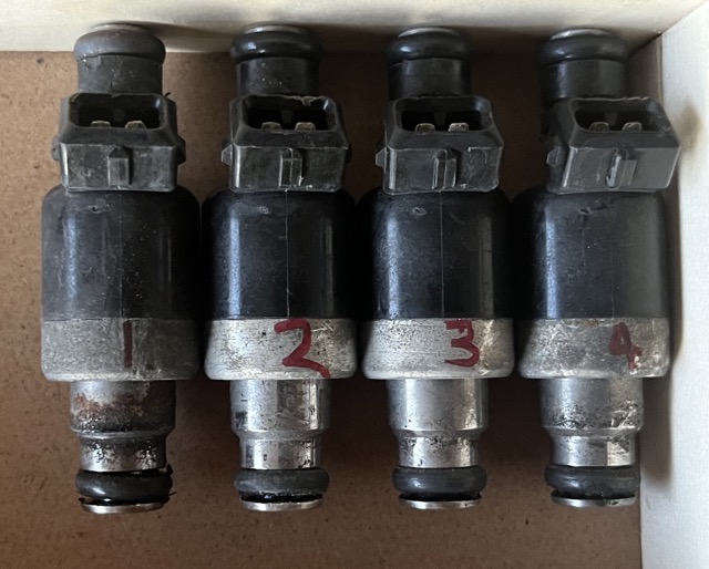

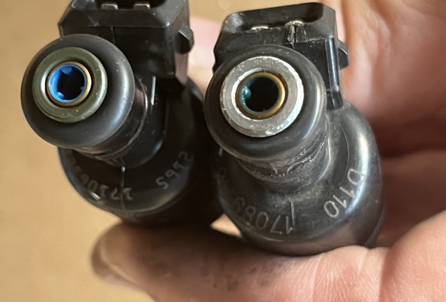

New on the left and old on the right
The replacements are 3mm shorter than the originals, however the seals are spaced correctly with only ~0.5mm difference.
The advert for the new injectors say that the new hole pattern is an upgrade. 5 holes, not 1. Well I can't vouch for any improvement coming from that, but there are definitely more holes.
#1 was quite shabby.

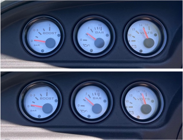

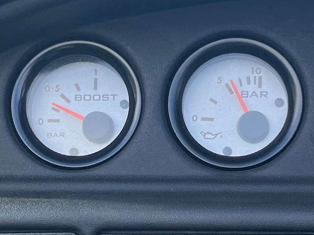

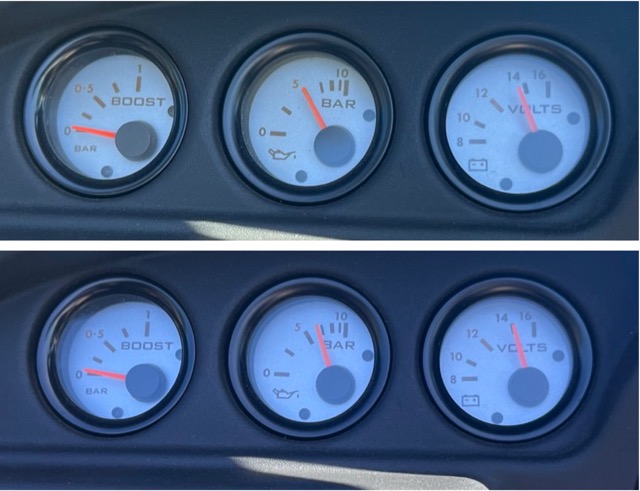

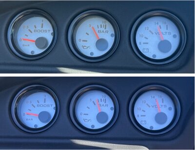

Today I solved the mystery of why my oil pressure sits steady at different values depending on the day - it is dependent on the fan speed setting.
at idle with fan on (top) and off
at 4k with fan on (top) and off [it is being caused by the drop in voltage - would be an easy fix to put a regulator on the gauges, but I can't really be bothered with it]

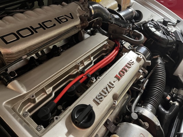

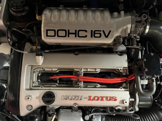

I was in the UK a couple of weeks ago and brought back a few bits that I've been working through. Here's the new leads to replace the temporary ones I found here:
They were about GBP30 from Classic Car Leads on eBay

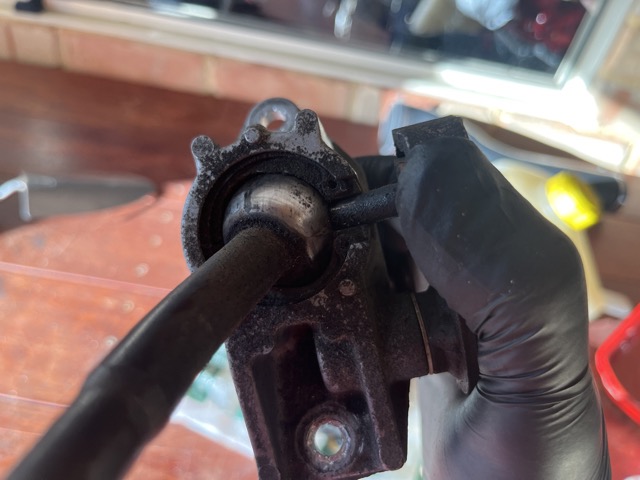

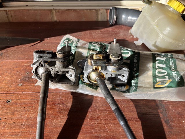

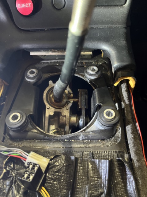

I've swapped out the gear lever assembly. It was a fun job and not so hard. With the car up on ramps it was easy enough to disconnect the cables at the gearbox and then to work at the lever end. I found the replacement on the UK eBay site for less than GBP80.
the old and the new - the old one was very worn
still works but a lot of freeplay
new one installed. A clear improvement in freeplay of the lever. There's still some although I don't think it can be removed as there will always be some lash in the linkages.

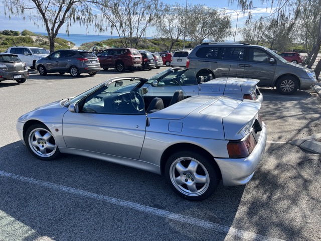

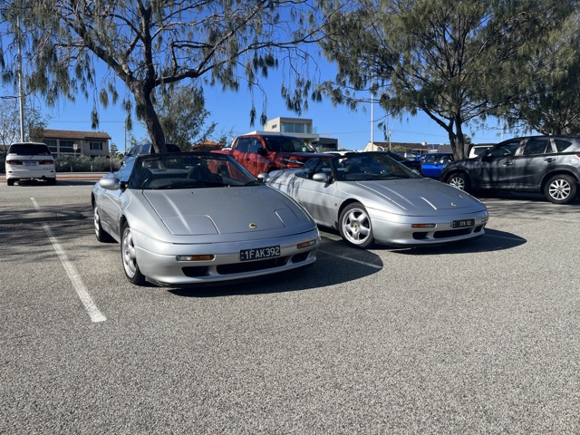

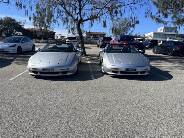

Steve made a friend today - an identical silver S2 which has just migrated to WA from the east coast.
Now one of us has our indicator lenses round the wrong way. But who?

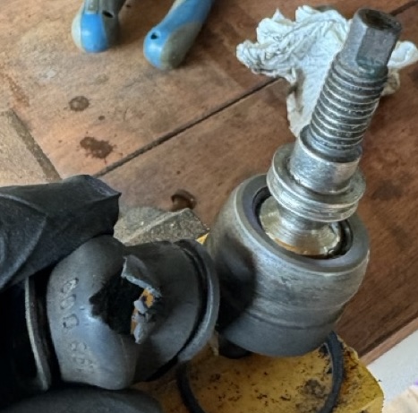

I was chasing a rear end clunk today, and while I did not find it I did find that my sway bar drop links need new boots. Has anyone sourced them, and could you please share the secret to your success?

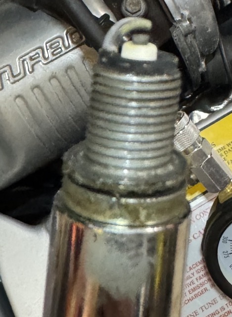

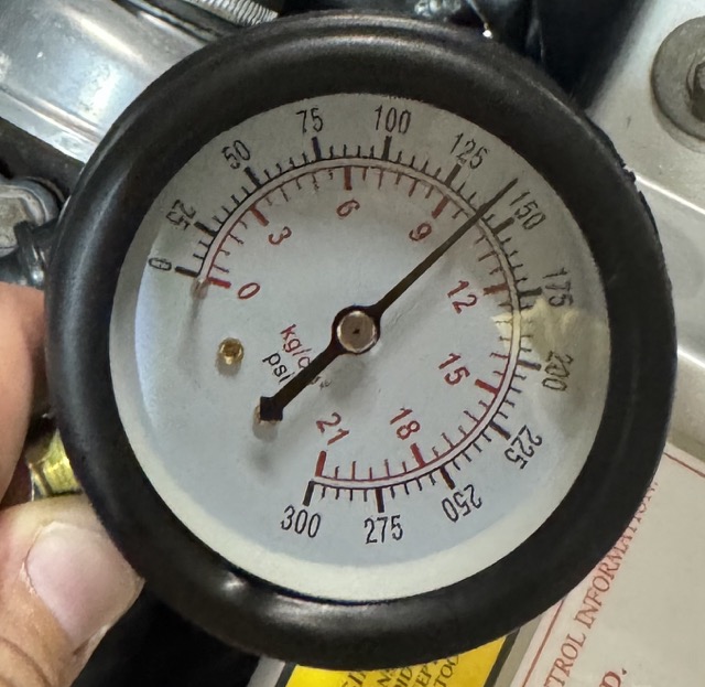

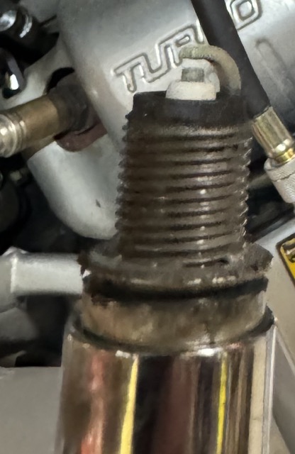

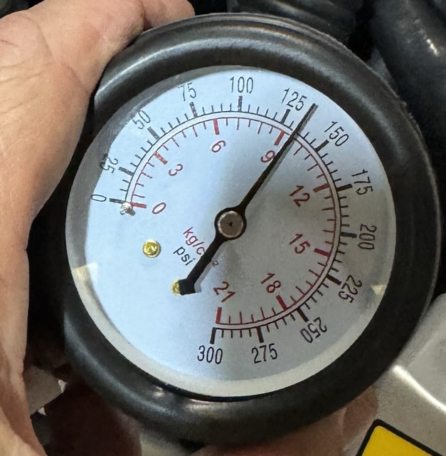

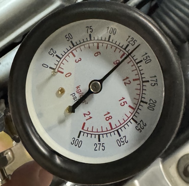

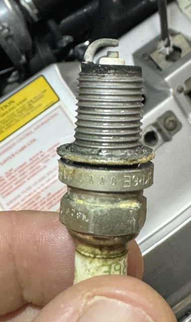

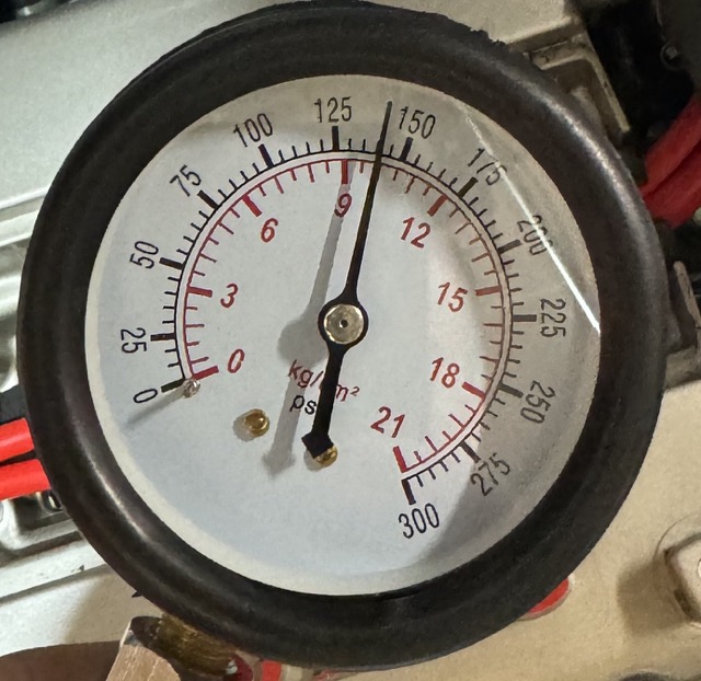

I ran a compression test tonight for the first time - how are my values? It's a cheap tester, the engine was warm (not hot) and I did not add any oil.
CL1
CL2
CL3
CL4

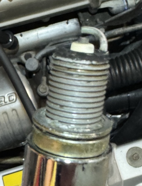

Spark 1
Spark 2
Spark 3
Spark 4
378S2
Posts: 268
Joined: Wed 09.09.2020, 02:19
Location: Australia
Postby Tuga2112 » Sat 02.03.2024, 20:48
i dont know much but those results look pretty good to me, nearly all cilinder show the same.

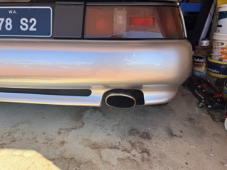

Hello All
My car turns 30 in a couple of weeks - and I have two jobs. Timing belt etc. (plenty of guidance, thank you) and a new exhaust. I would love a little exhaust advice please.
The one on there has annoyed me since I got it, because it's very loud and you can really only hear the exhaust and never the engine, I'd much prefer a quiet ride. Additionally it's broken the rear two hangars, the CAT hangs too low, and the welding looks like it's been done by a chicken... so it's time to go. Postage of a kit from the UK is absurd, so I am booked in next week for a new custom stainless system.
On a trip to the UK two years ago, I did bring back a new CAT section, so that's SJ replicated standard. I have asked them to build something quiet which doesn't reduce power noticeably. They're talking about putting in another muffler after the CAT and replacing the back box. I've seen some extra silencers that go in the rear wheel bay, but my local shop think it will go best underneath.
Any tips I can pass on to the shop please?
I will have to use a non-standard tip because a previous owner has opened up the bumper. I will most likely go for a twin pipe rather than this oval one.
Thanks for the help!
