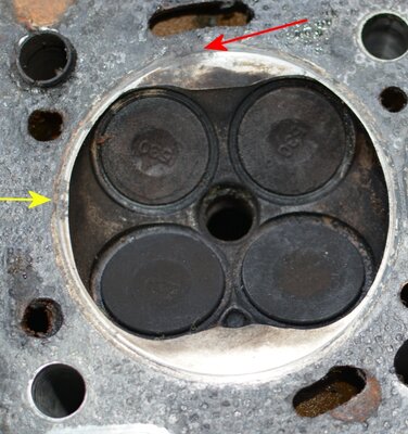

The cylinder head is now off and the steam cleaned top of No.1 piston confirms HGF.
No.1 piston steam cleaned
The head side of the gasket was the source of the leak - luckily only from water jacket to cylinder.
There's also a mark (yellow arrow) on the head which looks like the fire ring was breached there as well.
However I found some corrosion in the head around No.4 cylinder.
The corrosion ends about 2mm from the head gasket fire ring.
I'm not sure whether to get some more material welded in or just leave it - it's taken 29 years to corrode this far - what do you think?

The head was skimmed and new bronze valve guides were fitted, as like Jonathan F I had some corrosion on the leaking cylinder's guides which restricted valve movement.
Also had a 3-angle job done on the seats as they were being re-cut anyway.
The corrosion around No.4 was well away from the fire ring even after skimming, so was left alone.

Ron - did you know you had HGF, or suspected you had HGF, before you took the head off? If so, what were your particular symptons?
PS nice shiny head :smt023
Re: Step by Silky Step
Postby RonR » Sat 18.12.2021, 13:04
Yes Rambo,
I suspected it earlier this year when I had the occasional mysterious loss of coolant and the hoses seemed to be under a bit more pressure than usual. There was no emulsion in the cam cover so I knew oil and water were kept apart.
The clincher was on the way back from CC when I gave it the beans with what was subsequently found to be a stuck wastegate. The turbo over-boosted which I think was the last straw for the gasket.
Next morning the car wasn't happy, misfiring and puffing steam out of the exhaust.

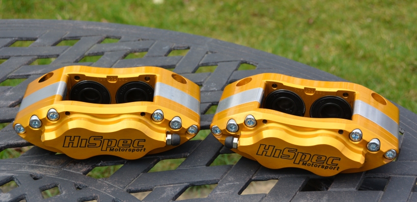

1. Front caliper rebuild with new pistons and seals.

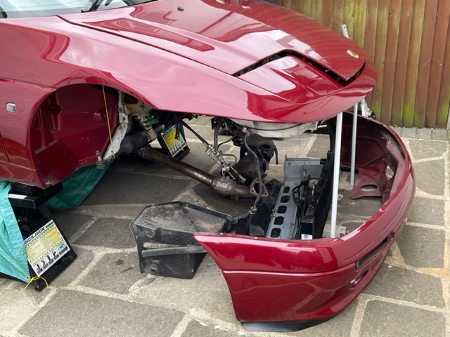

Took out the headlight pivot frames to free up the pivots and both bottom studs sheared off. The heads are sandwiched between the topshell and front cross-member. Found in the WSM that I had 2 choices - cut slots in the topshell or remove the front cross-member. The Longerons are off for powder coating anyway, so off it came!

Ron's is using a lift solution similar to this
https://www.ebay.co.uk/itm/233940443922
I been pondering such investment for a long time but my Elan originally cost me £1850 in 2014 and i just cant find the courage to spend 80% of the cost of the car in the tool that i use to lift it :bonk:
Postby RonR » Mon 09.01.2023, 13:03
Spot on Joao,
The lift paid for itself the first time I used it. IIRC it was around £900 from Costco - a QuickJack BL-5000.
BMW wanted £2700 to replace the front differential on my X1, I bought the lift and a set of bearings, rebuilt the diff myself and still saved >£1000.
It only just fits between the wheels of the M100, so if I was getting one just for that I'd get the smaller version, but the X1 was marginal on lifting weight so needs must...
