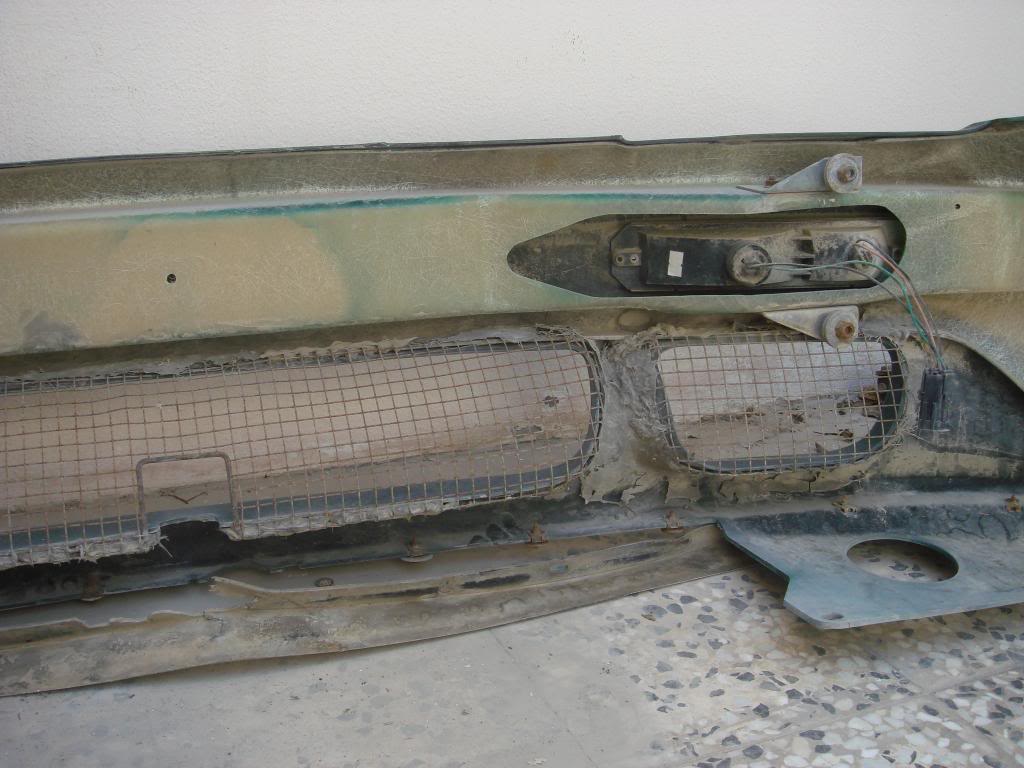

Postby Tuga2112 » Mon 15.09.2014, 21:50
this time scaled down the pics in order for them to look half decent.
front of the car as is right know. i have sanded almost all of it a hell of a lot because the paint was really bad.
this is a pic of an area where i havent sanded the cracks yet, it shows how bad they were. but the worst of it was in the bonnet, im hopping my dad got a good picture to show the state it was.
after removing the driver side doorcard (and breaking the "orange" clip) i decided to take a pic of the card. the bottom carper was glued in with some contact glue (hope thats the right name) i decided it looked really bad so ripped it off and im planning to replace it with something that looks less.... cheap... the vinil pads in my celica look really nice after 16 years, so im considering replacing with vinil, maybe leather, any suggestions or links for other people that have done such job are most welcome.
the upper panel also looks pretty cheap when its placed,
now, the reason i took out the door card was expecting to get easy access to the rubber seals (which are pretty much desintegrated)
sadly after the door panel was out i realised i was no closer to get access to the rubber seals and with a destroyed "orange" clip plus a door card without carpet (not much of a loss that one)
so here's a couple of pics of the door trying to get to show one of the screws i would like to get access to.
and finally just a random pic of the rear driver side after sanding. if you pay close attention you can see a completely different tone of blue on the hood cover panel. this had the paint in perfect condition up to the hood seal and then all cracked like the rest of the car.
the car appears to be originally of a lighter metallic blue colour and then repainted with the darker glossy blue.

this is the following update.
I got the light pods out today, no big issues, just the usual not understanding clearly instructions which i am used to. (technical terminology about cars is not my strong point.)
I will be posting a how to remove the pods with pictures because i believe it can help others. I know i would have felt more comfortable doing it if i had seen one.
I have had some help from john (on private email) referring the removal of the bumpers, it was enough to get the rear one out. but i am not comfortable tackling the front one with that i can see.
i have looked around the bumper and i know now the position of 4 bolts.
2 are the height adjusters just next to the wheel arch
2 are just under the light pods. (upper fixing nuts)
John sent me this picture from the manual with he's annotations refering areas of the missing bolts i cannot find.
Sadly following he's annotations i am still unable to locate the missing bolts.
I suspect i have found the 2 lower fixing nuts, John refereed in the annotations that i would get to the lower fixing nuts from the wheel arch but i dont think there's a way to get there, instead i found something while looking under the bumper that i think its the nuts im looking for.
In the following pictures you will see what im talking about and you can confirm if im correct.
Back on the topic of the light pods, here's a pic to show the paint job under the light pods. the same light blue metallic color shows up, one thing that i'm concerned about is that it appears to be very easy to over-paint that area, i don't think it did any harm previously, but its always better to ask before diving into the job.

The bolt you indicate looks about right to me - but it's hard to visualise from this angle.....
I've got a picture of the bumper off the car (stolen from different thread - courtesy of Wayne) which shows the fitting you need to get to....

thx dave.
That makes me 99.9% sure i have found the right bolt.
maybe tomorow we will have a [how to] on removing the front bumper :)
