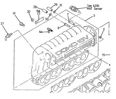

How about the hose to the MAP sensor #3 in second picture
It also attaches to the fitting #27 in the intake manifold

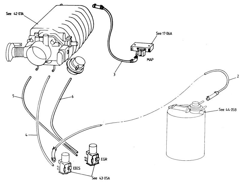

OR the other line #2 in this picture:
Click for larger view

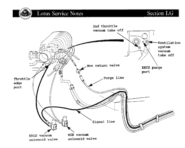

Postby Simon_P » Sat 01.03.2025, 23:23
TorqueHorse wrote:Ohh Ohh, I think I know this one. Is it the non return valve for the EECS purge line?
See this post - it is the "Purge Line" in the diagram and goes to one of the vac hoses on the back of the plenum by the throttle body.
