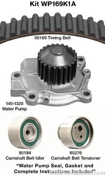

Still very easy. The timing belts are considered part of the engine "system" and the water pump is considered part of the cooling "system".
The other drive belts are considered to be part of the Belt Drive "system". You look up parts by their system.
The kit Intkin suggests does not include anything but the cam belt, idler, tensioner and water pump. The drive belts are in addition to the cam parts.

The only part that it is necessary to replace is the timing belt. I'm assuming that is your main intention.
Gaining access to replace the timing belt is time consuming (read expensive if you're paying someone to do it for you!).
The other three parts that are optional to replace at the same time are the idler wheel, tensioner wheel and the water pump. You don't have to replace these parts but if you don't and one of them gives way at a later date, it's very time consuming (read expensive again) to go back in and replace any of them.
So the general advice (i.e. most people do this) is to replace/renew the other three parts at the same time. That's why there's a Dayco kit that contains all the parts you need. Brit-car-nut is correct in that you can save a few quid by following his recommendations for buying separately. To be honest, I couldn't be bothered at the time so for ease I ordered the "all in one" kit (yes, I'm an eccentric millionaire ! :lol: ).

EDIT: Rockauto description of Dayco kit says gasket included (with instructions!!) so no need to order it seperately. John
Posts: 2541
Re: Cam belt replacement parts
Postby baldyash » Fri 04.01.2013, 14:07
Fredjohn---Sorry made an error I edited my post as it appears gaskets are included (didn't read info picture correctly) But I think you must have beaten me to it!!!!

It took me 3 looks to spot the text :bonk:
