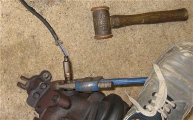

So how do I get it out? Spare one ready just in case, loads of penoil over last few weeks, bought an O2 socket, using it with Mole grips to stop it opening up and I'm only rounding the bloody sensor! :evil:
What should I do? Heat it or open up the cutout in the heatshield?

Postby GeoffSmith » Tue 01.01.2008, 18:07
Heatshield removal with the O2 sensor in place is in the Wiki.
Final picture of O2 sensor removal!
O2 sensor removal.jpg (21.37 KiB) Viewed 3933 times

Postby Dico » Tue 01.01.2008, 21:17
Nice brothel creepers there Geoffers :-)
What! an engineer with a copper hammer????
o2_sensor_removal_248 (Small).jpg (36.54 KiB) Viewed 3913 times
Postby GeoffSmith » Tue 01.01.2008, 21:19
I wondered who would be the first! They were fashionable 20 years ago. :smt016 The copper mallet was used during the second wave attack.
