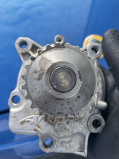

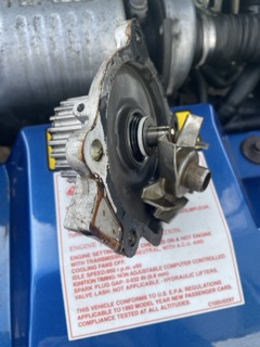

Postby Wevster » Mon 12.05.2025, 00:06
Failed pump
IMG_2159 2 Small.jpeg (21.48 KiB) Viewed 10764 times
Problem solved, when I removed the water pump the impeller fell off its spindle. It all looked good from the outside with no leaks, but unfortunately it didn’t last long or do much mileage as it was fitted October 2023, and as yet not covered a 1000 miles. No sure if it’s a recognised make.

Postby Tuga2112 » Mon 12.05.2025, 08:19
now its very important to know what brand is that. so we all can stay clear of it

Postby dapinky » Mon 12.05.2025, 09:28
Well, I'm sort-of pleased that my 'distant diagnoses' proved correct, but it isn't a good thing at all.
Clearly a faulty part, and I can only hope that it hasn't come from a 'faulty batch'.
Please can you let us know where and when it was bought, and which make it is (if known) as many of us will have spare units like this on the shelf ready-to-use and may benefit from that information.

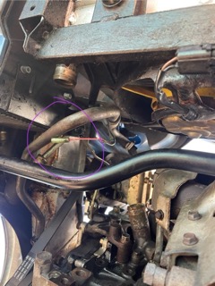

Thanks for the offer that’s very kind, I’m waiting for a new unit to arrive from PNM. I know the garage that fitted the old pump so I’ll give them a call to see if they can remember where it was from. Anyone know what this random red wire hanging down under the turbo right side of the engine bay, I can’t see anything obvious.

Postby Tuga2112 » Mon 12.05.2025, 19:19
i cant see because the picture is too small. but my guess given the location is that its the one that connects at the bottom of the power steering pump.

Postby dapinky » Mon 12.05.2025, 20:56
Tuga2112 wrote:i cant see because the picture is too small. but my guess given the location is that its the one that connects at the bottom of the power steering pump.
According to the wiring diagram, the wire for the PAS pressure switch should be black with a blue trace....... but it is in the right sort of location, so worth checking if there is a wire on the connector right at the bottom of the PAS pump

Postby KenS » Mon 12.05.2025, 21:23

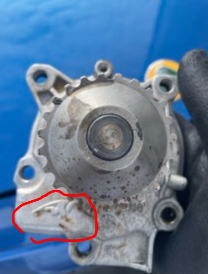

My S2 has two cables in that lower corner, one goes to the bottom of the power steering pump, the other is 'not connected', I assume its for air conditioning?
Interested in the water pump, the logo on the casting is for US Motor Works, looks like they can be sourced from Rock Auto and UK Lotus parts centers and ebay, part number US9221

Postby KenS » Tue 13.05.2025, 20:33
The logo is shown on the original photos of the failed pump, it is a 'US Motor Works' pump which seems quite common as a non-OEM pump, being supplied at times by RockAuto, UK Lotus parts centers, ebay. The manuf. part number is US9221
