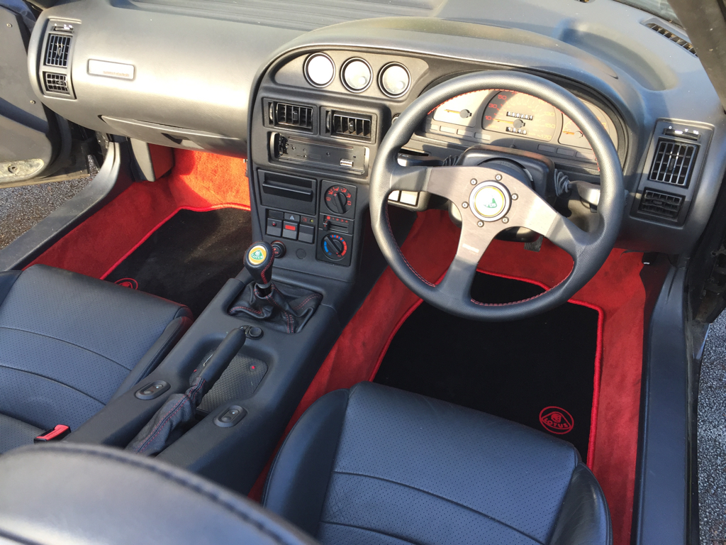

Finally, after a long long time, I've got the red carpet installed. Gone a big mad with the semi-shag pile on the rear bulkhead and the B posts. Gosh, it is hard to get flat carpet to wrap around the curves and bumps on the B posts.... Not very happy with the results, but it will do for now - I expect I'll be redoing those at sometime in the future.

Nice work Maz, very tidy, the seats look great as well. Where did you get the mats?.

(I found that the 'only' way to form the right shape on the 'B' pillars was to heat the carpet with a hair dryer until it was possible to mold it round the plastic - I tried with a hot-air gun, but it started to soften the plastic, so went the 'slower' route. Took a long time, but by applying a bit of spray glue once you are started, it is possible to stick the carpet down on one edge, then heat the next bit and stretch it, allow it to cool and glue it...move on to next 6" etc etc.)

Forgot to mention that the outrigger on the off-side was in pretty good nick. Some surface rust down by the pedals but brushed off, treatment applied and then closed cell foam installed under the carpets.
To be honest, the seat mounting points/seat belt mount etc look like the car just came out of the factory - I was very very pleasantly surprised.
