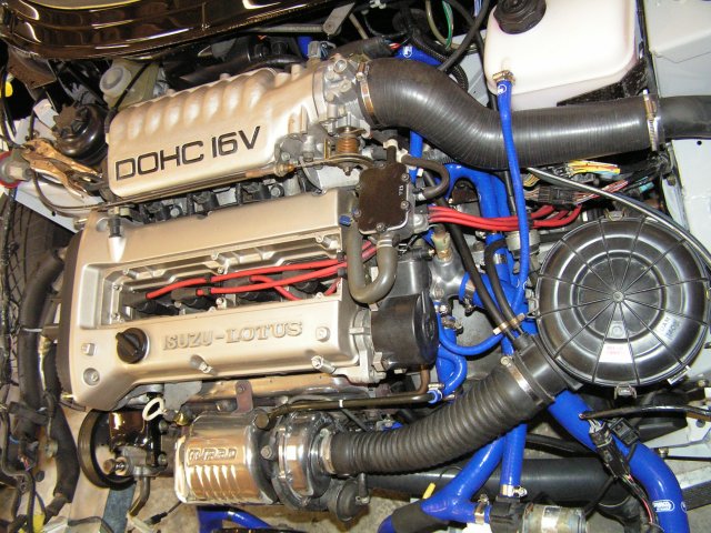

Any back on subject, finally got my samco hoses fitted and had engine running up to temp, sweet as a nut ! Mind you, when its ticking over and you give it sharp blip of throttle when the revs come down I get a lively backfire. Has anyone else experienced this after fitting a peco and porting wastegate? Or has my timing altered slightly, I did have the cas off but it went back on the exact same place because I marked where it met the head with a centre punch before removal. Apart from that no leaks or drips in sight. :D

Postby Enright » Mon 23.07.2007, 23:18
I have a ported wastegate and 2 1/4" SS system, and I get backfiring on the over-run on the move, but never while stationary.
Looking forwards to seeing the finished result. It's been a fantastic project.
Mucho kudos. :D
Postby robp » Wed 25.07.2007, 18:23
Mines exactly the same as enright - over run and backfires with a 2 1/4 and ported wastegate, also have an everest chip. cant say i have noticed it stationary. Will try next time i have the car out and let you know.

Enclosed is pic of the samco hoses fitted, a welcome burst of colour to the engine bay !

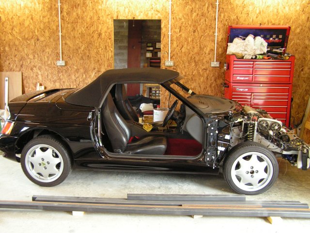

Today was a bit of a milestone, as you can see in second pic, the elan has touched down :banana: You kind of forget how low it is after sitting on axle stands for so long.
Well, its taken about seven months (on and off) to get this far, but there is still a fair amount to do, mainly all the front end body work and paint work not forgetting the doors. No point in rushing now because Ive missed the best of the summer anyway (what summer?) so Im just going to take my time and have it finished by spring 2008 :shock:
At least its on the ground now so I can trial hang the doors before I paint them (they are next on the paint list)
Also still one or two small jobs to do underneath including all the brake calipers to rebuild and the anti roll bars to fit.

Postby Rambo » Mon 06.08.2007, 14:57
Looking excellent Jamie - keep up the faith
Only a very minor point, and it might just be the photo or my fading eyesight, but it looks quite high at the rear - the distance between the top of the tyre to wheel arch ??? There is quite a gap normally with the bog standard 15" wheels (the 16" S2's fill the gap better IMO) but I remember someone on here (maybe ChrisT or Monty ?) changing their old shockers to new (Federal ??) ones and it changed the ride height so they changed them for something else?? Or is my memory going as well ??
Postby Rambo » Mon 06.08.2007, 15:04
For info. Jamie, I've just gone and measured mine and the distance is a massive 3"
Postby ab2cv » Mon 06.08.2007, 15:19
I agree with Rambo on the rear ride height. Mine is definitely lower (but then maybe my springs are old and saggy?). Blue hoses look great though - Mine have just arrived, so now I need to have a go at fitting them.
Alan
ab2cv
Posts: 619
Joined: Wed 30.06.2004, 18:30
Location: Edinburgh
Postby Rambo » Mon 06.08.2007, 15:41
ab2cv wrote:I agree with Rambo on the rear ride height. Mine is definitely lower (but then maybe my springs are old and saggy?). Blue hoses look great though - Mine have just arrived, so now I need to have a go at fitting them.
Alan
Good point Alan - I hadn't thought of that one - my springs will be old and saggy too !!
Postby jimbob » Mon 06.08.2007, 16:00
Although the car looks high at the rear, bear in mind its just been let off the axle stands and the boot has no spare in it etc so once it rolls around a bit it will settle down. Well spotted though !
Incedentially for anyone who is interested, the use of federal spec shocks will not, I repeat will not alter your ride height!!! :shock:
Only the use of federal springs will increase the ride height. :wink:
08 VW Caddy TDi
jimbob
Posts: 254
Joined: Tue 05.09.2006, 09:07
Postby Rambo » Mon 06.08.2007, 16:09
jimbob wrote:Incedentially for anyone who is interested, the use of federal spec shocks will not, I repeat will not alter your ride height !!!!
Agreed. Sorry - I meant to type in springs not shocks !!
